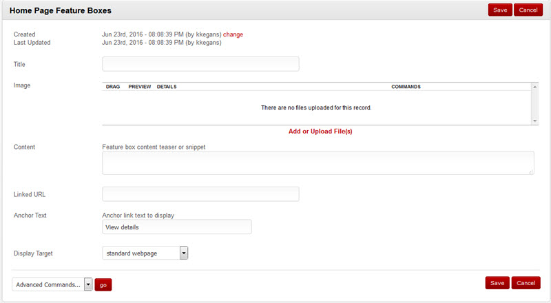

Was it by design or oversight that this occurred?  I believe it leads to a poorer UX that we were able to have before, and unprofessional display results.
Please look at the attached images.

You can do an override as a temporary fix. Create a file called custom.css in the main cmsb folder.
# sets the help text to red - optional
.form-inline .div-inline-block:first-child .help-block {
    color: #f00;
# override the display property just for the pre-text
.form-inline .div-inline-block:first-child {
    display: block !important;
Jeff Shields
