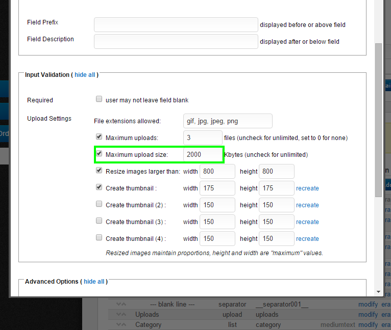

If you set a maximum file size on upload field, the script should automatically reject any large files (See attached screenshot).

I've already set-up the back-end as you describe. The point I was trying to make is that this setting has no effect on large files. It doesn't matter what size is set in the "Maximum Upload Size". (I can even leave it blank for "unlimited" file size.) If I try to upload a file above (say) 20mb, the system will always crash. The upload gets to 100% and then the page reports:
"No 'tablename' value specified in url!"
I need to fix this!

It's likely that this issue is caused by the server rejecting files of a certain size before the PHP script runs. Please can you fill out a second level support request for me:
If you can include the section and field that's causing the issue, then I can take a closer look at the problem.
