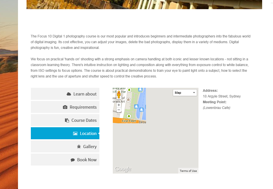

Thanks for that.  Just purchased the Geocoder, which is great,but I am only getting the top corner of the map location at www.focus10.com.au/courses2.php?1 rather than the full map.   I have attached a screen grab of the problem.  Any ideas how to fix this?

Hi Carole,
This is a problem related to the Javascript framework you're using (Bootstrap, and specifically Bootstrap Tabs) and Google Maps. Because the tab with the map is hidden when the page first loads, the map has trouble displaying itself. I think a solution may be to trigger a 'resize' event on the map when the tab is shown, as described here:
https://github.com/twbs/bootstrap/issues/2330
If that doesn't help, you may find more information with this search -- it seems like this is a very common problem for Bootstrap users: https://www.google.com/search?q=bootstrap+tab+google+map
Hope this helps!
