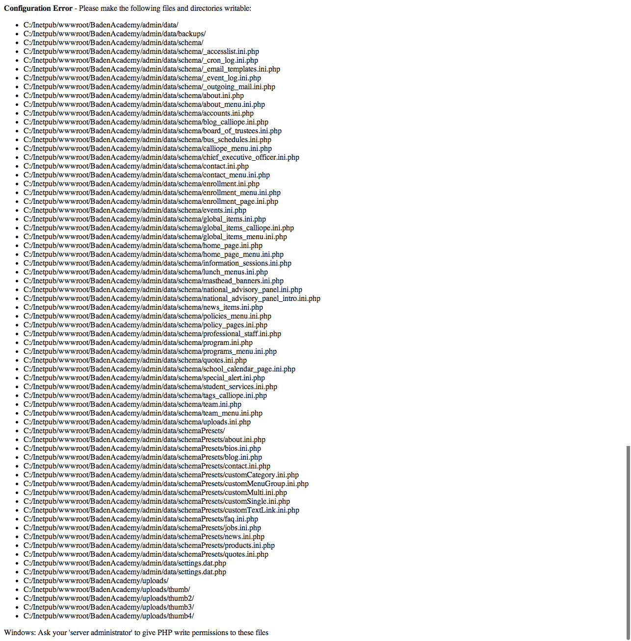

I tried what you suggested, I deleted the is file isInstalled.php and tried to reinstall. I have attached a screenshot of what happened afterwords, the server could not change the permissions of anything. So I tried a fresh install in a new directory, uploaded everything new and ran the installer and got the following:
Error renaming 'C:/XXXX/wwwroot/XXXX/adminNEW/data/settings.dat.php.default'
!Make sure this file and it's parent directory are writable!
I was hoping this was going to be the fix, simple and quick, but now I'm at more of a loss than before.
Chris
install.png 447K

Based on the image, the CMS Builder files are still not set to writable.
Can you ask your client to make sure all the folders are files are set to writable (full permissions):
/cmsAdmin/data/  - the folder, sub-folders and all files within it
/cmsAdmin/uploads/  - the folder, sub-folders and all files within it
We run CMS Builder on internally on our Windows machines so if the permissions are set correctly, CMS Builder will run without any issue.
