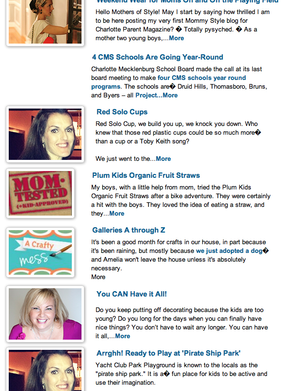

Here is a screenshot of the strange character. It looks like a "?".
April
screenshot-characters.jpg 486K
By gregThomas - January 24, 2013
Hi April,
The question mark blocks usually appear when a browser is unsure how to display characters because it doesn't recognize the encoding. CMS Builder stores its data using the UTF-8 character set. Could you check the header of your page to see if the page is displaying in UTF-8? Your header should look something like this:
<!DOCTYPE html PUBLIC "-//W3C//DTD XHTML 1.0 Transitional//EN" "http://www.w3.org/TR/xhtml1/DTD/xhtml1-transitional.dtd">
<html xmlns="http://www.w3.org/1999/xhtml">
<head>
  <meta http-equiv="Content-Type" content="text/html; charset=utf-8" />
By design9 - February 1, 2013
Yes, I am using UTF-8. However, I still get those characters. Do you know any other reason that would cause it or how to strip those characters?
Greg,
Yes, our web editors will often copy and paste  content from a word document etc. I always tell them to paste using the plain paste button. When I go back into the WYSIWYG, I don't see any strange html or characters but if I backspace and delete the space where the character is showing, I can delete it. It is just a slow process.  The strange thing here is the characters only show up when we use the auto-feed coding. It doesn't show up when the editors input the content directly into the home page backend area. However, I don't know if they are cleaning it up when they input manually on home vs. when it is being auto-feed straight from blog area.
This coding is on our home page and a new design page I am using. It is in the tabbed panel that says Blogs.
www.charlotteparent.com or www.charlotteparent.com/newdesign.php
Was trying to figure out a quicker way to avoid it or having to manually go into each blog post and delete where it is appearing.
April

By Codee - February 24, 2013
