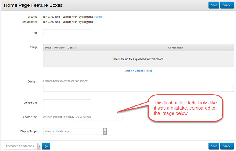

By Kurt - June 23, 2016 - edited: June 23, 2016
Was it by design or oversight that this occurred?  I believe it leads to a poorer UX that we were able to have before, and unprofessional display results.
Please look at the attached images.
By Damon - June 24, 2016
Thanks for letting us know. I will look into it and get back to you.
