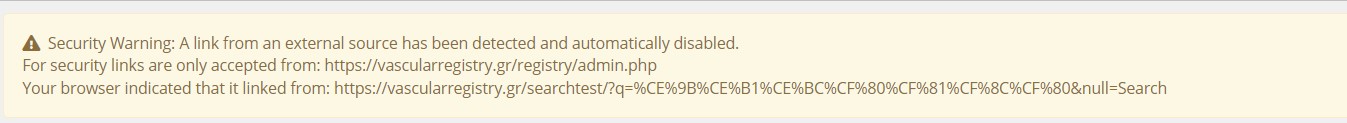

  3. On the link for each one of the results records there appears a question-mark (see image 3) and when I click on this link a warning appears (see image 4) which does not allow me to open the record
  4. Also, the Next button does not seem to respond. Probably, due to the fact that there is a LIMIT of 10 in the SQL query. I cannot find where this SQL query is located.

3. The link-building portion of this function is currently incomplete - I would recommend constructing your own links in the page's output.
Regarding the warning: if you need this to open viewer/editor pages in the CMS it will need to be built into a plugin - I had forgotten that it's not possible to directly link to the admin from non-admin pages. Otherwise, if it'd work to view/edit on the front-end like you're doing with this test page, the simplest way would be to either use a regular details page from the Code Generator (view) or use the Form Generator with record editing enabled (edit).
