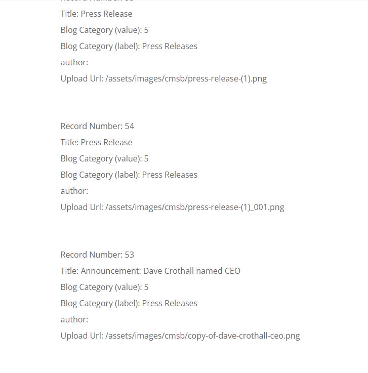

Hi All -
I have  a section that breaks up articles into different catagories then I display those catagories of articles on different pages.  I have done this a lot on websites but it is not working here and for the life of me I cannot see what is going on.
Below I have identified the components This is where it pulls the records for the page - if I do a record count for that subset of records (see below) the total records lists 15 (which is accurate) but when I do a foreach loop to loop through those records 6 records show up and they are all for category 5 (see attachment for results example).  This code is from a test page which I built to see if I could figure out the issue which is why there are some variables in there that are not normally there.
I am out of idea's it makes no sense to me.  Any help is appreciated.

By daniel - March 28, 2022
Hey craig_bcd,
Unfortunately, the issue isn't apparent just from your code snippets here - I have a few questions to help narrow it down:
  • Is what you've pasted below the full code on the page? Since the meta array contains the correct number of records and differs from the length of the records array, I am curious if there's any point after getRecords() where the $x_newsRecords variable could be getting modified.

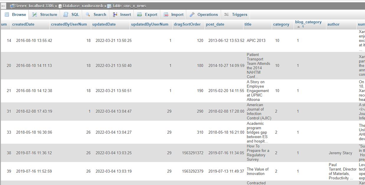

Thanks for the help - well I don't know how to explain this but here are the debug results  and i  posted the whole page code below.  Also I took a screenshot of the x_news table in the database and you can see there are records with blog_category = 1
Please let me know if you need anything else.

php-myadmin.JPG 104K

I think this is a different issue than in the first post - your "where" syntax is a bit off. This:
'where' => "'blog_category' = 1",
Should be this:
'where' => "blog_category = '1'",
This is likely the reason it's returning 0 records at the moment, but in your first post the syntax is correct and it's returning records - just the wrong ones. Try correcting the above issue, but also feel free to send a support request: https://www.interactivetools.com/support/request/

By craig_bcd - March 28, 2022
you are right!  see below - still not sure why the #5 records show up in the foreach loop
