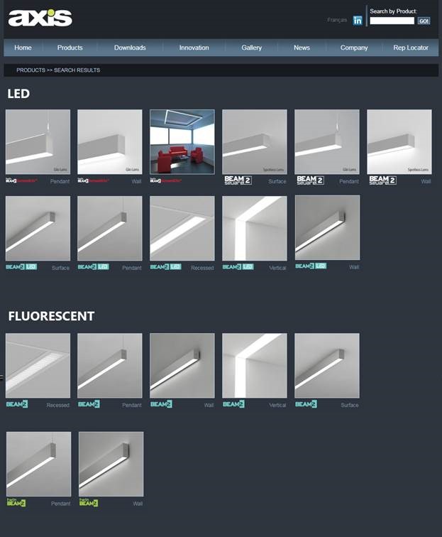

I have a search results page that I have when you search a keyword it returns the product. I want to sort the page based on the 'lamping' which is a database field. I can use the sorting in the url:
http://www.axislighting.com/CMS/search-led.php?lamping=LED
But I want to sort all LED products on the top and the rest on the bottom with a <h1> separating them.
How do I do that? See attached files.

No. I want to search by keyword, but I want the results to be separated into sections based on the lamping...

I only showed the url as an example of the results I want to achieve. I want the search results to be separated by lamping headers. How do I go about that. Forget the url string...

By dccreatives - June 20, 2018 - edited: June 20, 2018
ok. Seems like we might have something here.
However, 2 things. First, some products have more than one image and I only want it to show the first image, currently it is showing all.
Second, I want to  separate the Lamping by either LED or other... So I need separate headers to show LED first and then FLUORESCENTbeneath it..
Can you help?

By leo - June 22, 2018
To show the first image of a record, you can directly use the first element of uploads field. For example: $record['images'][0]['urlPath'] will be the url path of the first element of "images" field uploads.
To organize the record array by let or others, you can manually set the if statement to pick them out first. For example:
foreach($itemsGroupByLamping['led'] as $record){
  // Display LED records
foreach($itemsGroupByLamping as $category => $records){
  if($category !== 'led'){
    // Display other records
Or you can set order by to make led records the first of the array and use 1 foreach loop to display them all.
Leo - PHP Programmer (in training)
