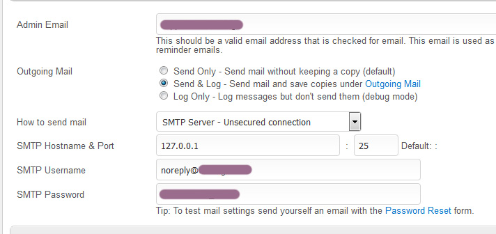

SMTP settings are attached in screenshot.
Mails are sent in the cases of 99% but errors always triggered.
