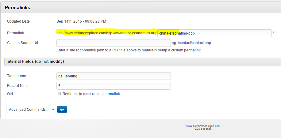

Greg -
Thanks so much - I apologize for being so thick, I believe I see what you mean but  I am not exactly sure what should go in place of line 11 but it does not seem to reflect the url correctly (see uploaded picture).  I am not sure what to do at this point.
thanks for your help.
Regards,
Craig

permalink.PNG 30K
By gregThomas - October 5, 2015
Hey Craig,
You need to adjust line 11 so that it is the relative path from the base directory of that site to the CMS permalinks dispatcher.
The path used on the permalink field in the CMS that is shown in your screenshot is there to show the user what the final URL will look like. It gets the URL from the general settings of the CMS.
