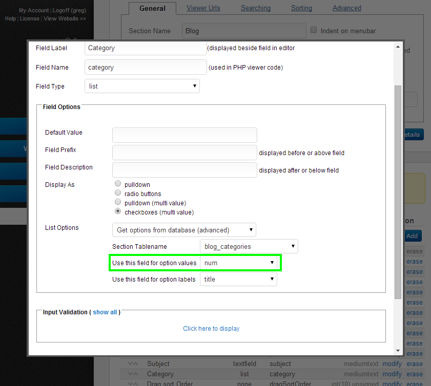

What are you storing as the value for the field? Is it the record num? (See attached image for example).
I'm wondering if the code isn't working because the num value isn't being sent over.
