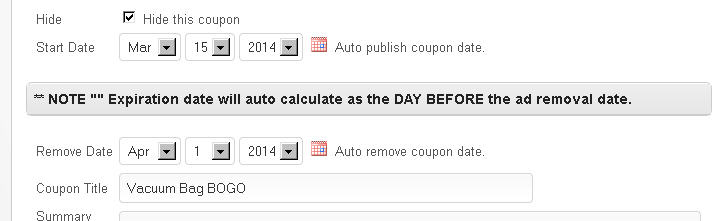

Well, the date you should be entering is the REMOVAL DATE (May 1) and not the expiration date of April 30.  As long as the administrator understands that the expiration date that is published is calculated from the removal date it works fine.  I always put a note above the removal date field as a reminder and have never had a problem. (see attached jpg)
Ron Conring
Conring Automation Services
