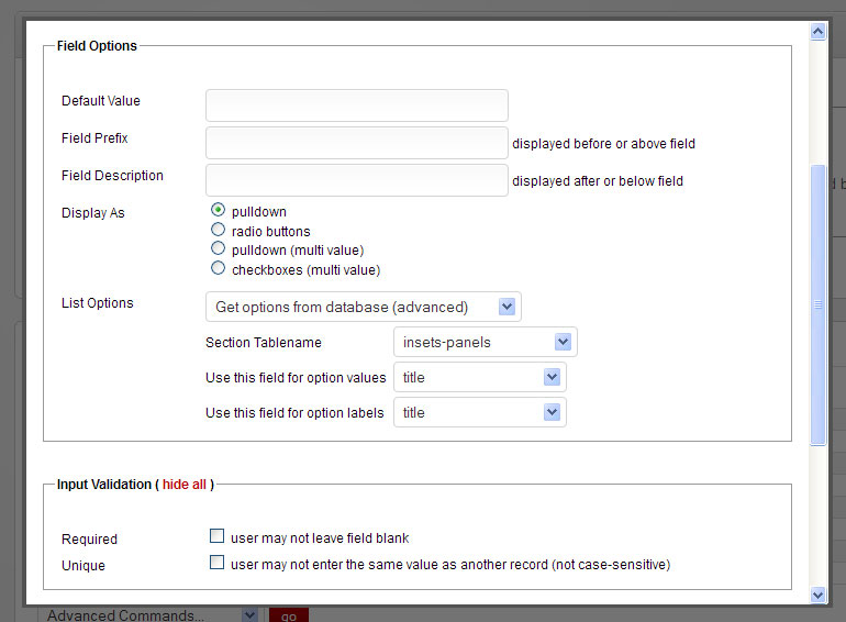

I've set up the CMSB for the Services page so that the user can choose which record in "inset-tables" they want to use (see attached), but how do I get the corresponding panel to actually appear on the page? I.e. if they choose, say, "Antiques" from the drop down menu, the corresponding Antiques panel appears on the page.

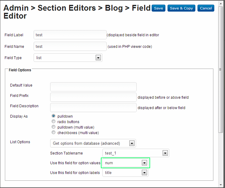

By gregThomas - March 19, 2013
Hi Nigel,
The easiest way to do it would be to make two separate MySQL calls to get the full data from your inset-panels:
First, I would change your list field so that the value that is stored is the num value for the record (see attached image).  Then your code on the page should look something like this:

example_007.png 17K
By CommonSenseDesign - March 19, 2013 - edited: March 19, 2013
Thanks for your advice, Greg.
I've attached one of the sample pages where I would like the inset panel to appear, like a "dynamic" include, as it were. This is how it should look: http://kathiejordandesign.com.previewdns.com/services.php
In CMSB, I've changed the corresponding list field to num, as you suggested. The code I'm using to retrieve the relevant table is as follows:

Sorry, but I'm not sure which values I should be changing in your version, and what should remain untouched?
Also, should I be placing
<?php echo $inset['title']; ?>
where I want the panel to appear on the page?
Thanks again.
