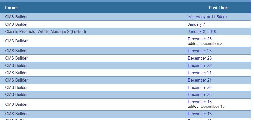

2) Discovered an oddity (not a major issue or a problem).  When I look at my profile's posts it appears they sort by the full date except posts from the Article Manager forum which appear to be showing up based on month/day only.  I attached a photo of a 2010 Article Manager post mingled in with my current posts so you can see what I'm talking about.
cmsb-forum.jpg 63K

@everyone: Message received: if we add Unread Topics, it'll have to work cross-device. Thanks for the input!

@sidcam: I'll add your #1 to the list too. Thanks for #2, I've fixed that.
