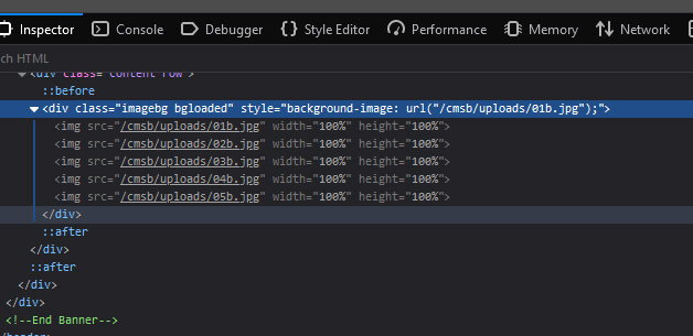

By Steve99 - October 31, 2023
Hi CommonSenseDesign,
It appears you have code that is setting an image upload as inline style background image on the div tag. I can see 5 image tags output within that div as "display:none;". Can you post the full code sample that creates this section (see attached screenshot)?

Hi, Steve. I've attached the code for the entire page. You can see the live page here: https://www.interfaithcounselling.ca/lottery/rules-calendar2.php
Thanks so much.
By Steve99 - November 14, 2023
Hi again,
It looks like Djulia's shuffle solution will work nicely for you. Based on your existing code structure, here's a slightly modified version to shuffle if there is more than one image upload:
