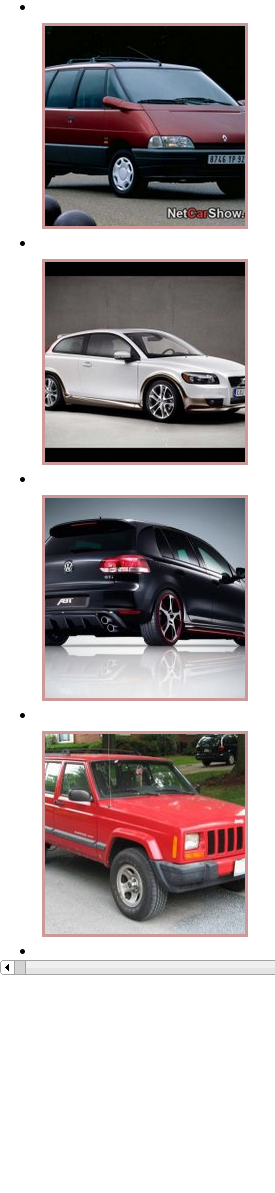

If you wanted to make the images crop automatically to the right size, you'd replace the img tag with the div tag, and make the thumbnail display as a background image. I've attached an image of an example I made using my car test section. Here is the code I used to create it:

So we're using a div tag, and using each images thumbnail as the background image to each div as we cycle through them. The thumb styles will ensure that the image crops and centres for each.
So with your code in the previous post, you just need to replace the image with the div system I've used in my example code, and include the thumb styles in your style sheet.
