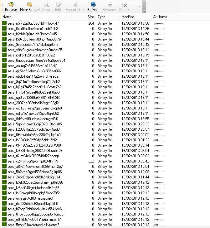

>Another issue we're seeing is PHP creates a zero byte file
I think that I have a similar problem. Currently, I regularly remove the files on the FTP server.
I also use a custom folder for php sessions.
>We're trying out some code that automatically clears those
Can your code function with the previous versions (2.17)?
Thanks again! :)

By Dave - February 8, 2013
Hi Djulia,
Here's some code from 2.51 in /lib/init.php that automatically prevent zero-byte files from being left in the folder:
// Remove 0-byte session files on shutdown - added in v2.xx (not added yet)
// PHP _always_ creates session files, even when the sessions are empty.  This means 10 hits from a search engine spider creates
// ... ten 0-byte session files that won't be removed until after session.gc_maxlifetime is reached.  This can create tens of thousands
// ... of unneeded files.  This function removes zero-byte session files on shutdown by calling session destroy. For session in active
// ... use, unsetting all $_SESSION values will cause the session file to be removed, but the same file will be recreated on next page-view.
// PHP Docs Reference: "A file for each session (regardless of if any data is associated with that session) will be created. This is due to
// ... the fact that a session is opened (a file is created) but no data is even written to that file. Note that this behavior is a
// ... side-effect of the limitations of working with the file system... from: http://php.net/manual/en/session.installation.php
$useThisBetaFeature = false;
if ($useThisBetaFeature) {
  function _remove_empty_session_file() { if (!@$_SESSION && session_id()) { session_destroy(); }} // removes session file
  register_shutdown_function('_remove_empty_session_file'); // remove session file on shutdown
To enable this feature in 2.51, just set $useThisBetaFeature = true;
To add it to older versions, just copy these two lines into the init.php file in /lib/init.php
We'll be testing this for 2.52 and will likely leave it turned on for future releases.
And one last thing.  I had literally tens of thousands of zero byte files, so I googled I found some shell commands to remove them all at once from here: http://www.unix.com/shell-programming-scripting/44271-remove-zero-bytes-files-folder.html
Hope that helps, let me know any feedback or comments.  Thanks!

By Djulia - February 14, 2013 - edited: February 16, 2013
That does not seem to function on our server. The files continues to accumulate.
But, it is perhaps because of an incomprehension of my share or the configuration of the server.
Thanks again!
Djulia

By Dave - February 17, 2013
Hi Djulia,
In regards to zero-byte session file cleanup:
It doesn't erase 0 byte files that already exist, it should just prevent new 0 byte files from being created by CMSB that use the new code.  Also, keep in mind that your session folder might be shared by multiple domains.  So the 0 bytes files might be coming from others domains or other non-CMSB scripts on your domain.
Can you try the following test script?
<?php // session_removed_test.php
  error_reporting(E_ALL | E_STRICT);  // display all errors
  ini_set('display_errors', '1');
  // start session
  print "<h1>Session file Removed Test</h1>\n";
  session_start() or die("Couldn't start session! '$php_errormsg'!");
  $_SESSION = array();
  $sessionPath = ini_get('session.save_path'). "/sess_" . session_id();
  if (@$_REQUEST['remove']) {
    print "Automatic Removal - Removing empty session files.<br/>\n";
    print "Check if session file exists here (it should NOT exist): $sessionPath<br/>\n";
    print "then try <a href='?'>default PHP behaviour</a><br/>\n";
  else {
    print "Default PHP - Not removing empty session files.<br/>\n";
    print "Check if session file exists here (it should): $sessionPath<br/>\n";
    print "then try <a href='?remove=1'>automatic removal</a><br/>\n";
Or if that doesn't work, email me at dave@interactivetools.com so I can take a look.  I'd like to make sure this works for 2.52.  Thanks!
