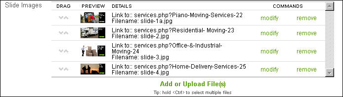

Step 1:  Create a field in a table that will be loaded for that page.  Mine happened to be home_page on this particular site.  This table holds data unique to the home page so is only 1 record.  The field is an upload field named slide_images and resize options are set to match the dimensions set in the slideshow script.  I use the info fields to hold target URLs for each image (if any). See attached Slides-Upload-Field.jpg

Step 5:  Upload your images to the slide_images field and drag them into the proper order.
