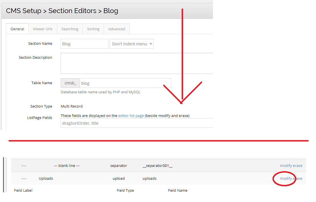

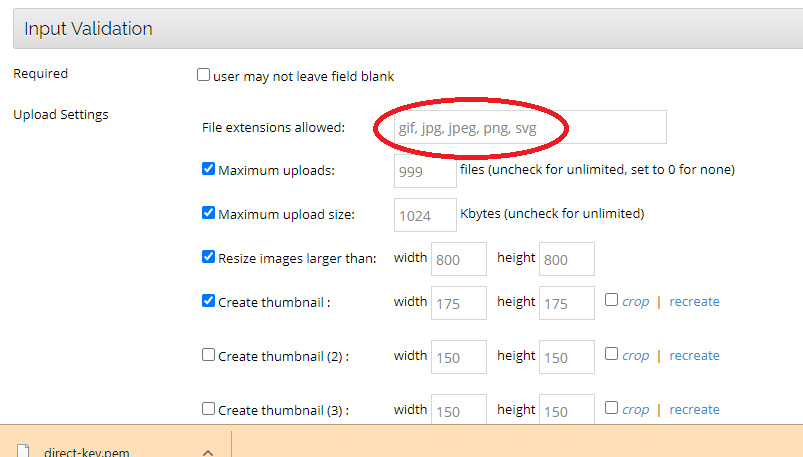

I believe the problem is in the configuration of the section's allowed file extensions. At one point, svg uploads were allowed, then the settings were changed that removed svg from the list of available file extensions.
To remedy this problem, go to the section editor in your admin panel > fields table (Has no label, but it's the last table on the list)
Look for a field named Uploads, then edit it by clinking modify. Then go to a section named "Input Validation" and search a column named "File extensions allowed". Check to see that svg is in the list of file extensions that are allowed to be uploaded.
Hans Marcon
