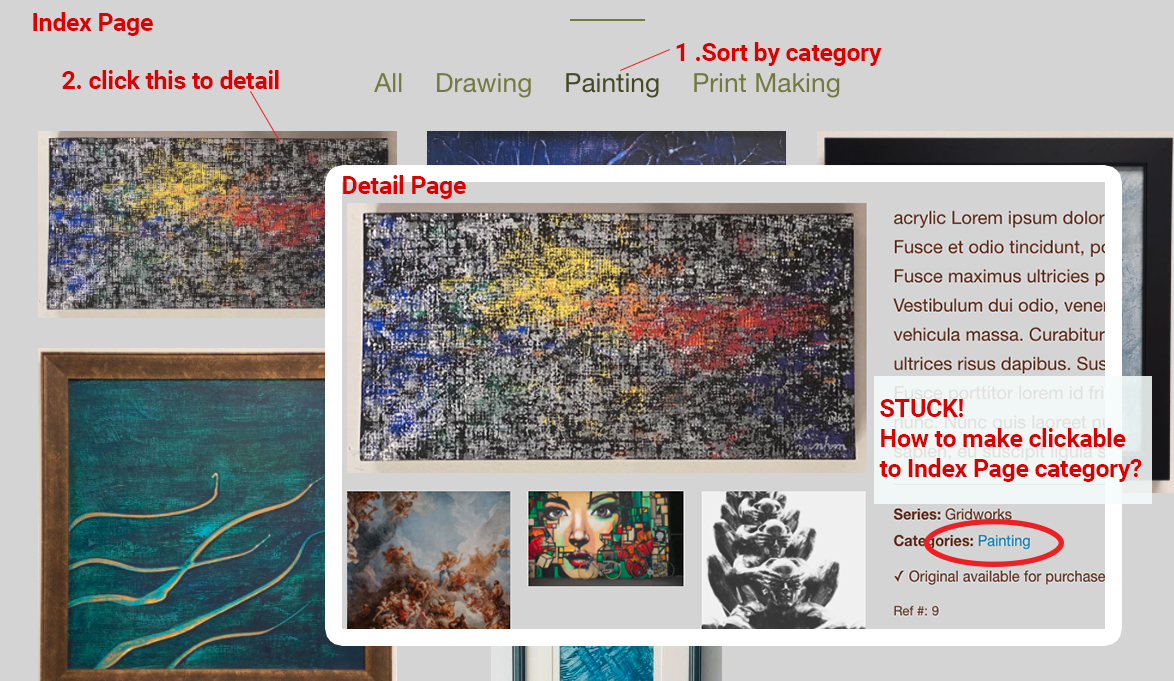

I have a multi record editor called Artwork. In it, I import a list of categories from another multi record using 'Get options from database'. The category records have a permalink. Everything there works fine and I have a sortable gallery with permalinks when the categories are sorted. Then, if you click on an image from Artwork, you get the detail page of that image. Pretty straight forward and common.
My struggle is on the detail page, itself. Under the artwork image I list out the categories that artwork is in. I would like those categories to be clickable and then the user can get back to the list page and see all the artwork in the categories. However, I can't figure out how to import the category permalink to the artwork detail page in order to make it a link back to the category page.
Image attached for visual reference.
Any advise is appreciated.

The solution in the linked post worked well.
I added this:
// load records from 'art_categories'
list($art_categoriesRecords, $art_categoriesMetaData) = getRecords(array(
'tableName' => 'art_categories',
'where' => '`name` IN('.mysql_escapeCSV($artwork_imagesRecord['category:labels']).')',
'loadUploads' => false,
'allowSearch' => false,
To use this:
<?php foreach ($art_categoriesRecords as $record): ?>
     <a href="/<?php echo htmlencode($record['permalink']) ?>" target="_self"><?php echo htmlencode($record['name']) ?>
<?php endforeach ?></a>
Now, I just have one semi-related issue:
The foreach outputs the array of "All, Paintings", for example. However, all of the artwork, whether drawings or print making, etc, is in the 'All category. How can I always skip the first key in this array so it never prints 'All'?
Skipping the first item seems like it might be really simple, but I've tried using an array_slice and various if statements, but my novice self just can't figure it out.
Thanks for any further guidance.

This should work if you're looking to skip the first item of an array:
<?php foreach (array_slice($art_categoriesRecords,1) as $record): ?>

Thank you! That is exactly what I needed. I was trying to do similar, but had the ",1" on the wrong side of the parentheses. I just don't write PHP enough to ever get even passably good at it... or even figure out what to search for sometimes. So, this is is much appreciated and saved me a lot of frustration.
