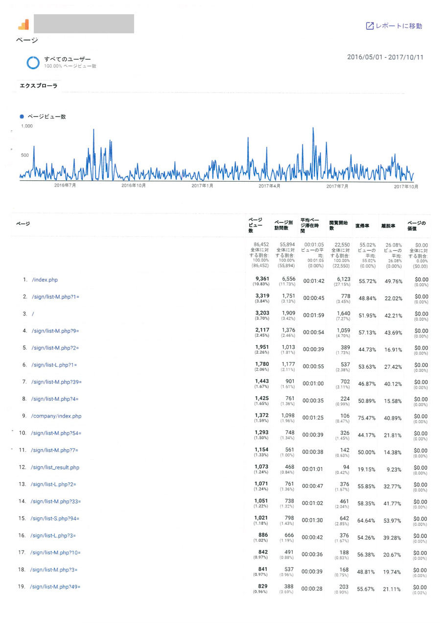

Google Analytics Report add "=" at the end of URLs

Hi Yusuke,
Google can add strings such as utm_source, etc to urls so get something like: viewer.php?123&utm_source=xxxxx
Reference: http://www.google.com/support/googleanalytics/bin/answer.py?answer=55578
We specifically strip these out in /lib/viewer_functions.php in the function: getLastNumberInUrl()
So I'm not sure what is causing the error.  Using the standard code:
      'where'       => whereRecordNumberInUrl(0),
It should work with ?123 or ?123=
What HTTP Error Code or message is being returned?  Let me know how we can help!
By yusuketaga - November 8, 2017
Thank you so much for your quick reply and a beautiful answer!
Everything is clear now.
It wasn't exactly an error message so please disregard it.
Thanks again!
