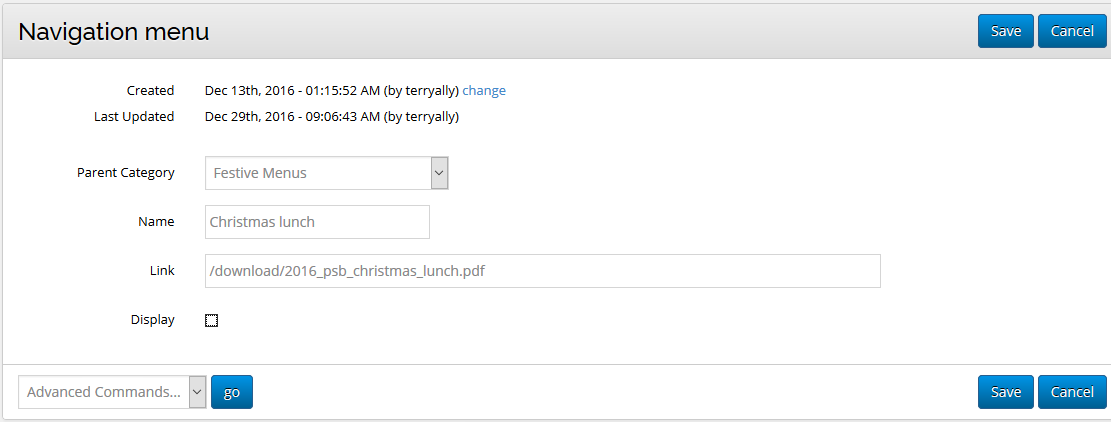

However, I want to hide 'Christmas Menu' in the Festive  Menus dropdown list. I do that by unchecking the 'Display' box in the Section Editor (see attached screenshot). When I do that it produces the following HTML structure which alters the original structure because it is removes the closing </ul> & ,/li> tags in this dropdown list and subsumed the items which follow as children and grandchildren (??) in this list. This is a built-in CMSB thing. I need to rectify this. How?

Terry

By gregThomas - January 3, 2017
Hey Terry,
This is happening because the li and ul tag HTML in the variables _listItemStart and _listItemEnd are created when the getCategories function runs. But the code that's being used to decide if the ul and li tags should be displayed is running after the tags have been created:
<?php if ($categoryRecord['display']==1): ?>
  <?php echo $categoryRecord['_listItemStart'] ?>
  <?php if ($categoryRecord['_isSelected']): ?>
    <a href="<?php echo $categoryRecord['link'] ?>"><?php echo $categoryRecord['name'] ?></a>
  <?php else: ?>
  <?php endif; ?>
  <?php echo $categoryRecord['_listItemEnd'] ?>
<?php endif; ?>
So when records with display set to 1 are not displayed, the ul and li HTML no longer align correctly.
The getCategories function doesn't allow you to pass a where statement into it, so the best solution is to update the section in the CMS so that it use the Hidden checkbox (mentioned in the post by Damon above) instead of the display checkbox, then the records you don't want displaying will be automatically filtered out by the getCategories function, and you won't have to use an if statement to stop the records displaying.
