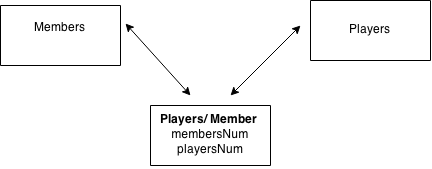

If I was implementing this system, I'd store the players chosen by users in a separate section to the player. I've attached an example of how I'd a link the sections together (the members would be your front end players). You'd have to use the mysql_count function to ensure that users don't have more than 5 players stored against their account.

Although you could use the Favourites plugin to build this system, you'd have to modify it to only allow users to save 5 favourites and it would have less flexibilty, so it might be better better to build your own system. Although building your own system will probably take longer.
Let me know if you have any specific questions about the implementation.
