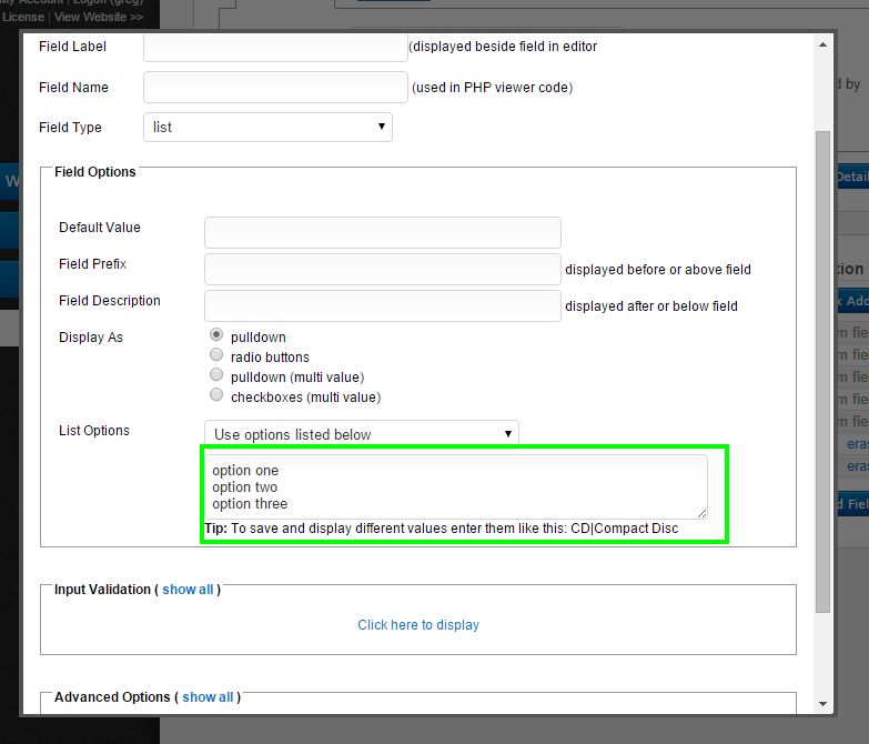

You're MySQL statement looks like it should work to me, my guess would be that Archived isn't what's being stored in the database. Can you let me know what's being used in the text area for list values? You can find these by going to Section Editors -> Stallion List (modify) -> Status (Modify). Then copy the code that appears in the text area (see attached screen shot) into a post. Also, is this a single select list, or a multi select list?

Thanks for sending me that extra info Tina, I can see what the issue is now. I think it should work if you change your code to this:

As the status field is a multi select, the values that are chosen are stored in database as a tab separated string. So you have to search that string and check it doesn't include the Archived value.
