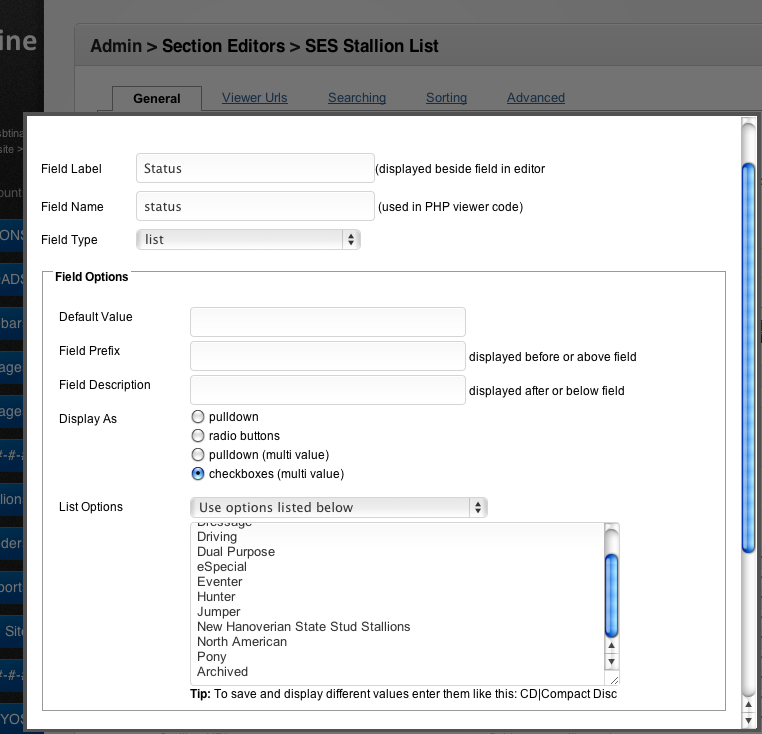

You're MySQL statement looks like it should work to me, my guess would be that Archived isn't what's being stored in the database. Can you let me know what's being used in the text area for list values? You can find these by going to Section Editors -> Stallion List (modify) -> Status (Modify). Then copy the code that appears in the text area (see attached screen shot) into a post. Also, is this a single select list, or a multi select list?

My screenshot is attached - scrolled to bottom to show "Archived" on list
Could the problem be because of the way I listed each breed on the page? I was having issues getting it to display any other way and had to get it online and I think at that point I needed to move on but now I have time to make it right if that's what needs to happen.
I took a screenshot of the code & just attached the page because when I paste it, it does not maintain line breaks.

Thanks for sending me that extra info Tina, I can see what the issue is now. I think it should work if you change your code to this:

As the status field is a multi select, the values that are chosen are stored in database as a tab separated string. So you have to search that string and check it doesn't include the Archived value.
